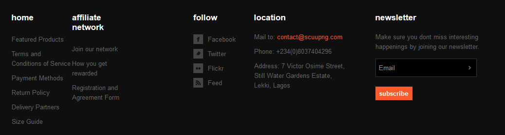

June 12, 2013 at 6:11 pm #495699here is the link

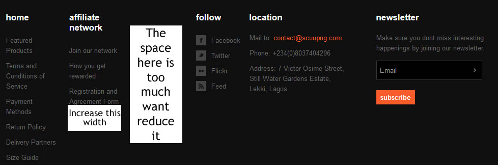

http://zamoonda.org/scup/index.php/clothings/blazers-jacketmore so please how can i give the links at footer more padding because they are to close to each other, i have tried using development mode and it not given me the desired result

June 12, 2013 at 10:39 pm #495712Try this . . .
Within file path —> /scup/templates/ja_hawkstore/css/bootstrap-responsive.css
at line 166, add a “padding-left” property – for example:
.row-fluid {
-moz-box-sizing: border-box;
display: block;
float: left;
min-height: 30px;
padding-left: 20px;
width: 100%;
}Does that achieve the desired separation you were looking for?
June 13, 2013 at 10:53 am #495774i have gone through this file path administrator/components/com_virtuemart/html/browse_1.php and did not see the folder called html
just folders assets,controllers,elements,helpers,install,liveupdate, models, pluggins,tables,viewsJune 13, 2013 at 11:03 am #495776thanks bro……i have tried that before it did give it a padding but the width was still small, i want to believe this is the css controlling the width,but have not been able to fine tune it to to increase the width of the first three columns on the left
.row-fluid .span3 {
width: 25%;
}i have tried changing from 25% to 30% and this distorts the social icon menus.
thanks
