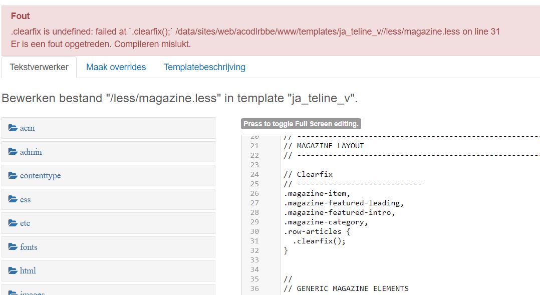

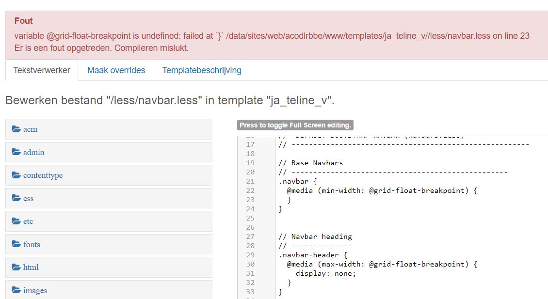

I’ve inserted everything as you explained but ran into another problem… I can save all the less files, but when I compile them to turn them into css files I receive several error messages. Now, you didn’t instruct me to compile the less to css but (at least that’s what I thought) you MUST do that in order to let the changes in the less-files take place. Am I correct?
Anyway, I made screenshots of the three error messages. (note: the Dutch line "Er is een fout opgetreden. Compileren mislukt" means "An error has occured. Compiling failed.). I didn’t get an error message while compiling the variables.less file.
What I found strange was that the errors occur on lines that I haven’t changed… For instance: the error in navbar.less file occurs on line 23 but the changes in the Navigation Themes start somewhere at line 450.
And for the error in the megamenu.less file, there seems to be an error in the grid.less in the T3 Bootstrap folders. And I didn’t go anywhere near those files (better still: I don’t even know where they are…).Am I doing something wrong??

July 25, 2017 at 4:34 pm #1051492Hi Werner,
There maybe something wrong in the syntax of LESS code you added. You can share credentials of your site: URL, Admin + FTP account and backup your site.
If your site is running with Development Mode (check in template manager), it will load LESS files and after changing less files, you just need refresh your site.
Otherwise, if Dev mode is OFF, you need to compile less to css to take affect.

July 27, 2017 at 10:09 am #1051931Hi Werner,
In the ‘navbar.less’ file, you missed the code for a tag:
.cat-brandweer { > a { &:hover, &:focus { background-color: @brandweer !important; } } &.active > a, &.open > a { &, &:hover, &:focus { background-color: @brandweer !important; } } } .cat-haven { > a { &:hover, &:focus { background-color: @haven !important; } } &.active > a, &.open > a { &, &:hover, &:focus { background-color: @haven !important; } } }I added for you and it’s working now.
