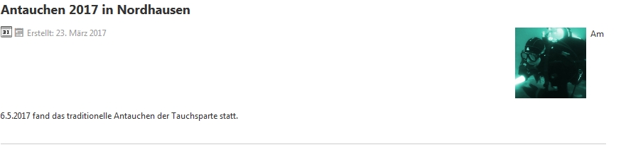

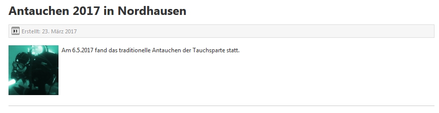

    I own 3 homepages using T3 + purity II.
    After updating to Joomla 3.8 the Category Blog design is broken.
    Main entries are still ok.
    Category Blog: http://www.union06.de/tauchen/
    Main entries: http://www.union06.de
    The first entry on Category Blog ist also a main entry (look for the thumb).
    This is the second page with broken Categor Blog:
    http://www.sgs-hannover.de/index.php/news-archiv/
    Is this a know issue or a different from menu problems with 3.8?
    1. diving_news_cat_blog
    2. diving_news_main
    #1064134
    The new version of Joomla has changed in markup so pls wait for the new release of T3 framework before updating to this new version of Joomla.
