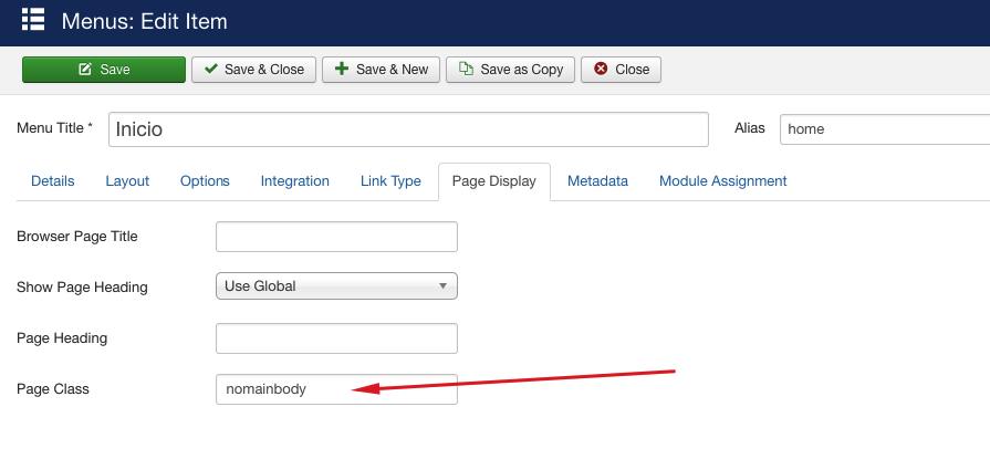

I am figuring out how to make the "skip component content" option work in the homepage. Here is how my setting is done:
-Specific layout used on homepage (and only in homepage) -Skip component field is pointing to the menu item set as "Home" (the default menu item)

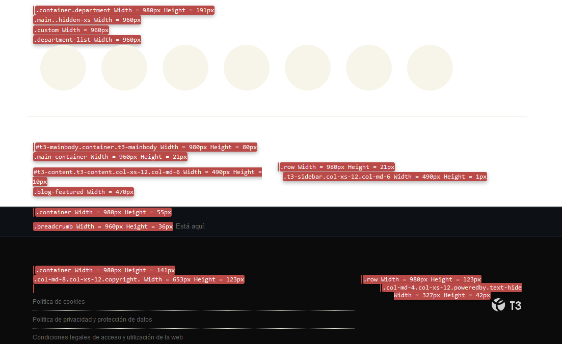

But… see picture attached. The component appears to be still there (and the corresponding blank space).
Thanks in advance for your support!
January 9, 2017 at 9:11 pm #1001025Hello
You can indeed use a workaround for this
Add to your /local/css/custom.css file this custom code
.nomainbody .t3-mainbody { display:none; }Then edit your HOME menu item and in page display tab -> Page class add the nomainbody custom suffix
This will hide the mainbody only for the home page
I already did it for you now and as you can see it is disappeared.
