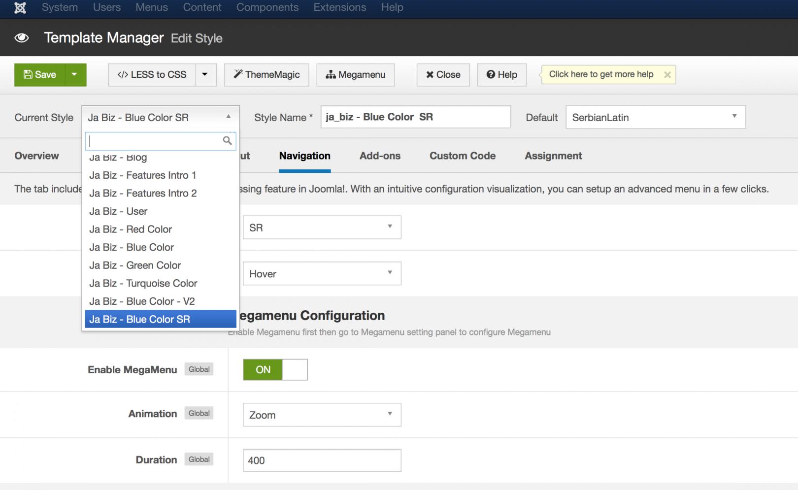

May 23, 2014 at 10:14 pm #536460It looks like I realize an issue.
Just to add here since it might be helpful for someone else.
Beside caching basic parts for another language as:
– New main menu is assign to different language (sr)
– Category is assign to different language (sr)
– Article is assign to different language (sr)You should copy Style and assign it to another language and add another language menu in this case (sr) menu.
Hope this helps!
