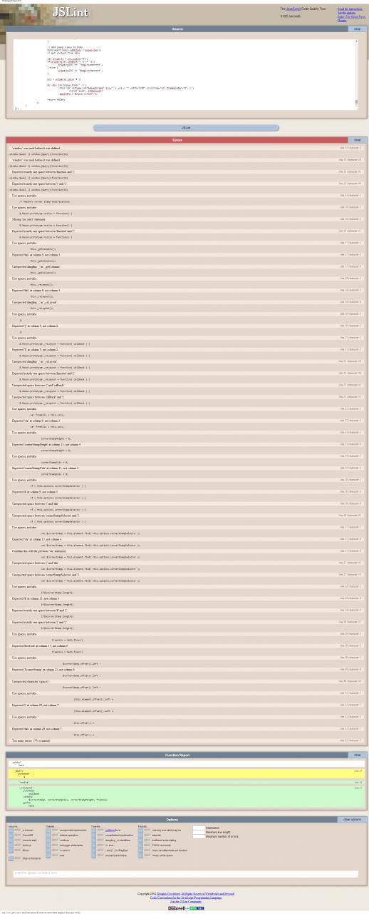

3. With regards to JavaScript, I have noticed that if I use an SEO optimization plugin like JCH Optimize, on JA Wall – The entire thing crashes. I can minify and join all the CSS files, but when I minify and join the JavaScript, it breaks the layout, now notwithstanding some JS may not be able to be joined, but for example there are several errors on the “wall.js” which when run through JSlint or the like to be fixed, they destroy the layout, so my question is, why are there apparent errors in the Javascript coding for this template? I have included a sample result from JSlint to this ticket.
