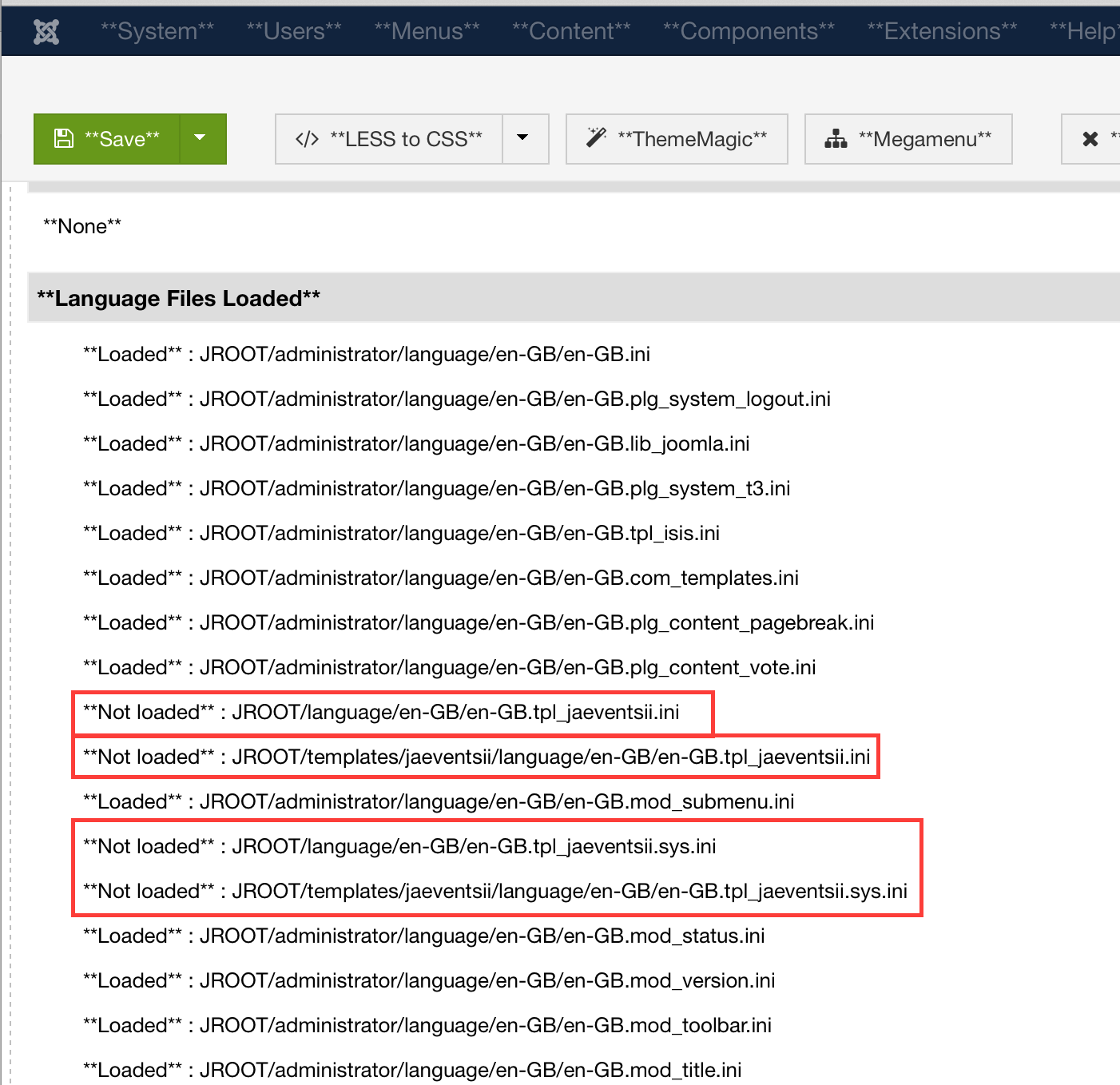

January 15, 2016 at 4:18 am #848305I enabled the debug language from backend of your site and saw the language is not loading on your site, see the screenshot
I uploaded both files and you can get it and copy them into path below
templates/jaeventsii/language/en-GB/en-GB.tpl_jaeventsii.sys.ini language/en-GB/en-GB.tpl_jaeventsii.sys.ini templates/jaeventsii/language/en-GB/en-GB.tpl_jaeventsii.ini language/en-GB/en-GB.tpl_jaeventsii.iniHope it helps

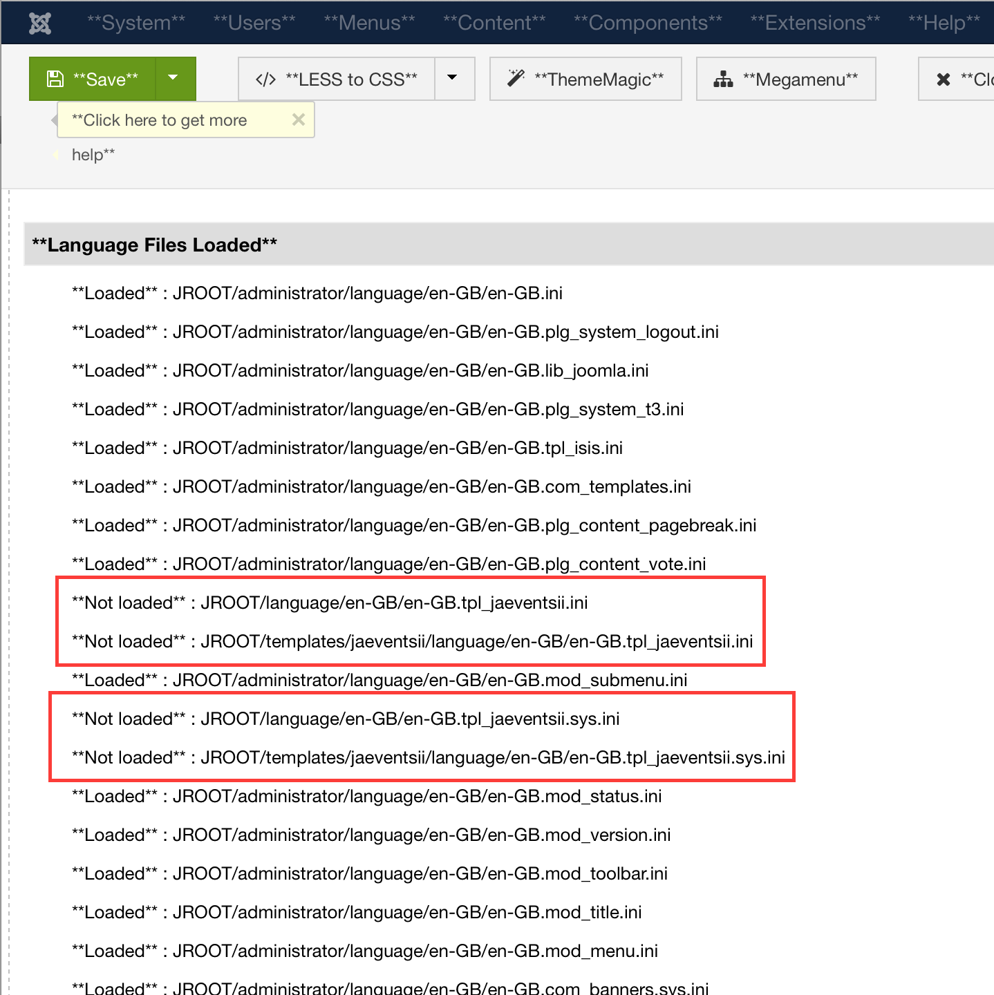

January 18, 2016 at 6:47 am #851330Please look at my screenshot and could not see the language files to load on your site. You can give me the FTP account of your hosting via Set as private reply. I will help you to check this bug.
About the problem with JAEM component, pls give it a try again.
