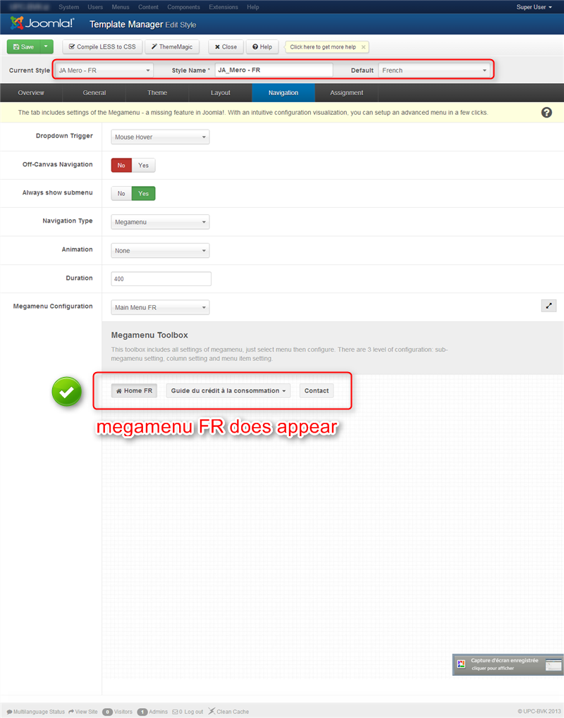

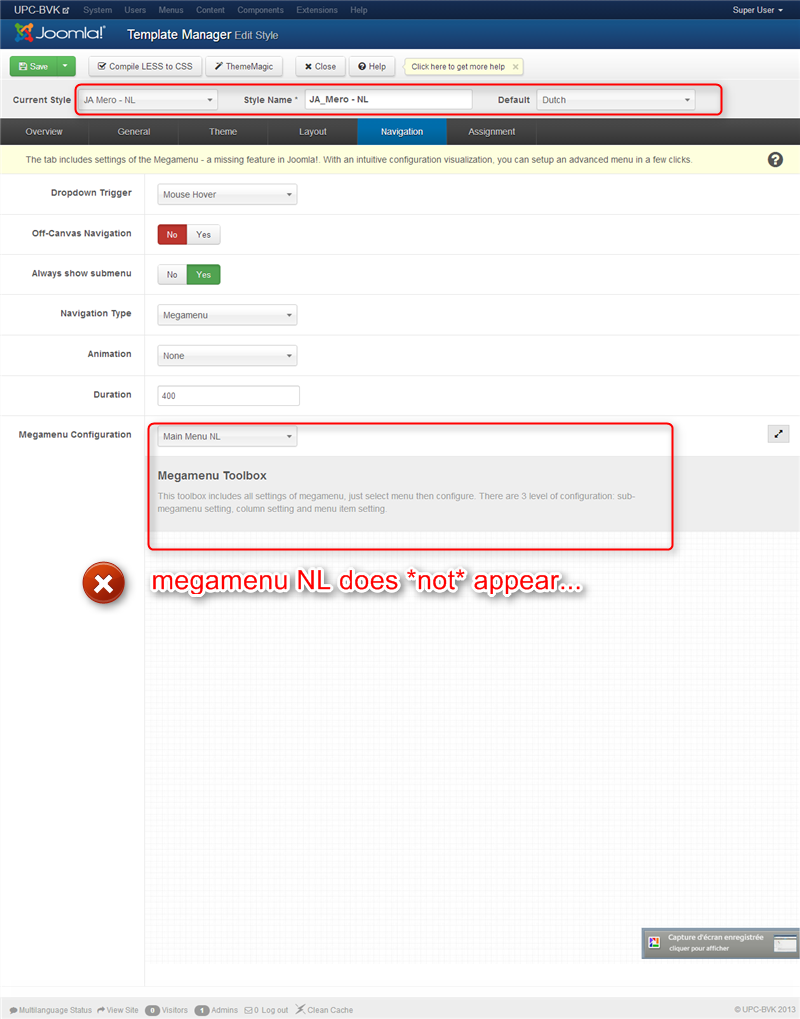

1. Mega Menu not showing in Template Manager for several Styles…
I have 4 Styles because my site is multilingual : “ALL”, “EN”, “FR” and “NL”.
I have activated the Mega Menu for these 4 styles, but still the mega menu does not appear for all Styles… meaning I cannot edit them !
Strange enough, having tried and retried many times (!), it has happened *once* that the NL mega menu did appear for example (this is how I could make it appear in my front-end).
But it looks like it appears randomly… and generally not.I don’t have a clue why this is so and I suspect some bug.
Here are the screenshots to make it clear and visual (FR working and NL not working) :

May 22, 2013 at 7:50 pm #493665Hi again,
I have investigated a little bit further for problem #1 above (Mega Menu not showing in Template Manager for several Styles).I thought “maybe there is a historical problem either with the template Style in question or with the menu which is called by the template style”.
So I created a brand new style and I created a brand new menu with its corresponding module, with the hope that this new template style would be able to show my new menu as a megamenu.
Well, bad luck, the answer is no…So, to illustrate the problem more interactively than my previous screenshots, here is a little video :
I select a given Template Style, go to Navigation tab. There, I choose as “megamenu” each of the available menus.
As can be seen, the FR menu does appear, as the ALL menu.
But the NL and the EN menu never appear in the megamenu zone to let me configure them…
Choosing again the FR menu, I see it correctly in the megamenu zone.Txs for your help ! this problem must be solved for this project and it becomes urgent.
