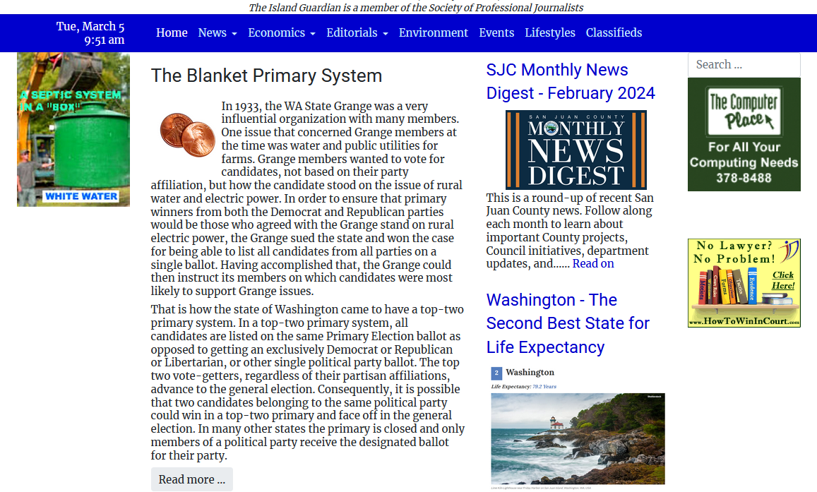

    Correct
    Here you can see that the columns are 2 (ad) 5 (component) 3 (local news) 2 (Search / ad)

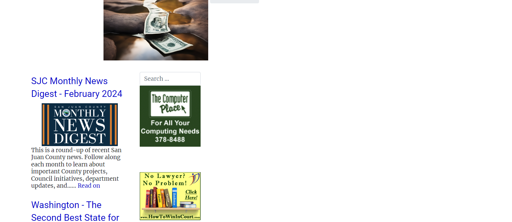

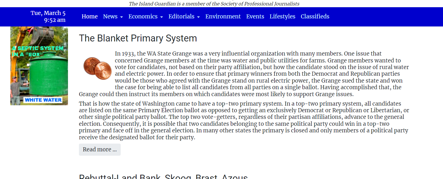

    Incorrect
    Here you can see that the columns are 2 (ad) 5 (component) - yet spans screen causing wrap - 3 (local news) 2 (Search / ad)
