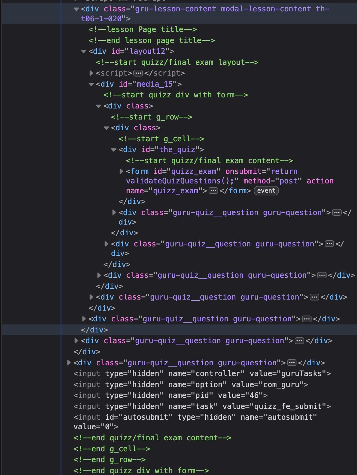

I am afraid that won't work, as the HTML code generated by Guru is totatlly unstructured, and the way each browser will interpret the missing divs is totally unpredictable.
Please see the following images.

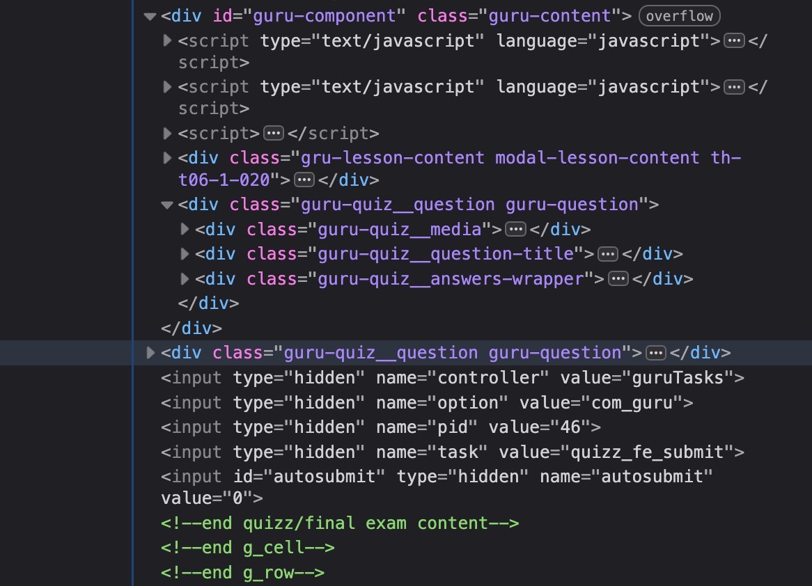

In this one, the last question is outside the div guru-component, and the second to last is outside the modal div.
And on this one, more question divs are outside where they should be, some even outside the div the_quiz.
This is totally wrong, and the way each browser will interpret it is just a random guess.

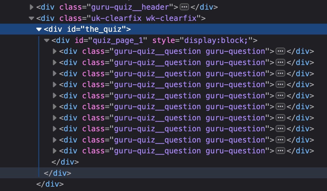

For comparison, this is how the questions are presented when visiting the results page NOT right after having taken the test.
That is the correct structure, and how the results should look right after taking the course.
