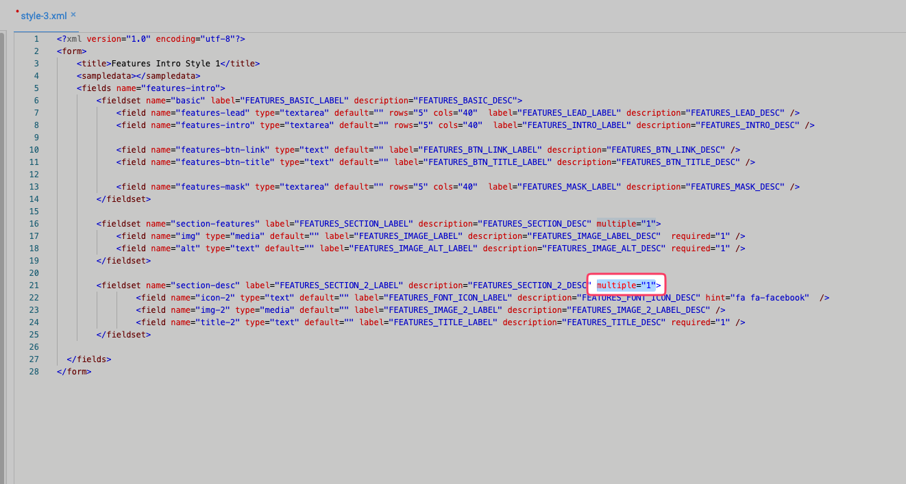

Features Intro: style-3
It is not possible to add an additional “Feature Details” (Background image) element; only the “Feature Content” element can be added as an additional element.
http://beta.borgomediterraneus.eu/menu-acm/item-test Menu item: ID 316 Mod ACM: ID 181 Position: section-3

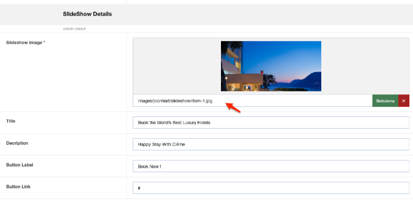

Slideshow : style-owl
No images from the slideshow are visible in the front-end.

It seems to be a bug in JA ACM module, I just updated this file: /templates/ja_resort/acm/features-intro/tmpl/style-3.xml
and remove the param: multiple="1" in the icon group so you can add new group for the background image now.

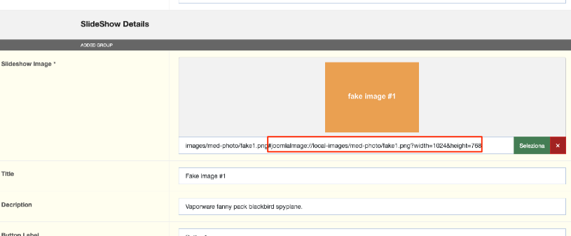

In any case, what I've noticed is that in the demo's Slideshow ACM module, the image URL is different from the new's Slideshow ACM module I created. There's an extra string of characters added to the image URL, and there's no way to delete it.
Hi @iorbita, I have added custom code to remove the parameters after the image when displayed on your website. You don't to care about the parameters when adding images in the slideshow module. Images displayed outside the website will have the parameters removed.
