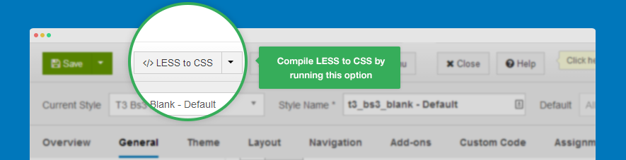

BACKUP your site first and compile less to css:
![](https://www.joomlart.com/forums/assets/files/2024-06-12/1718175893-665050-compile-less-to-css.png)
