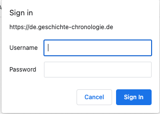

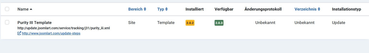

in mid-July, I successfully made an update from 2.0.2. to 2.0.3. on two completely identical sites jo.gesch... and ru.gesch... just like always before: via dashboard -> update.

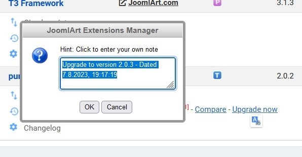

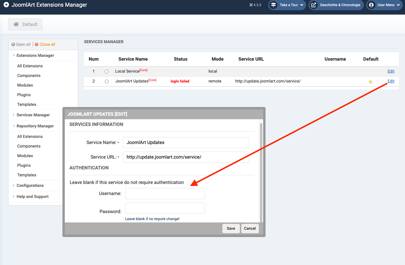

Since this time on the website de.geschichte-chronologie this method does not work, I downloaded JA Extensions manager component on your advice.
But first I decided to check how it works on a test site. To do this, I installed a copy of the de site on the jo test site.
To my surprise, the Purity 3 update via the dashboard worked there. So I couldn't check on the test site what would happen when using JA Extensions manager component.
I can, of course, apply JA Extensions manager on a worksite, but judging by the description of the component, it's not quite easy. So before that, I want to ask you, what are the chances of success? Or is it better to try deleting the template and installing it again?
