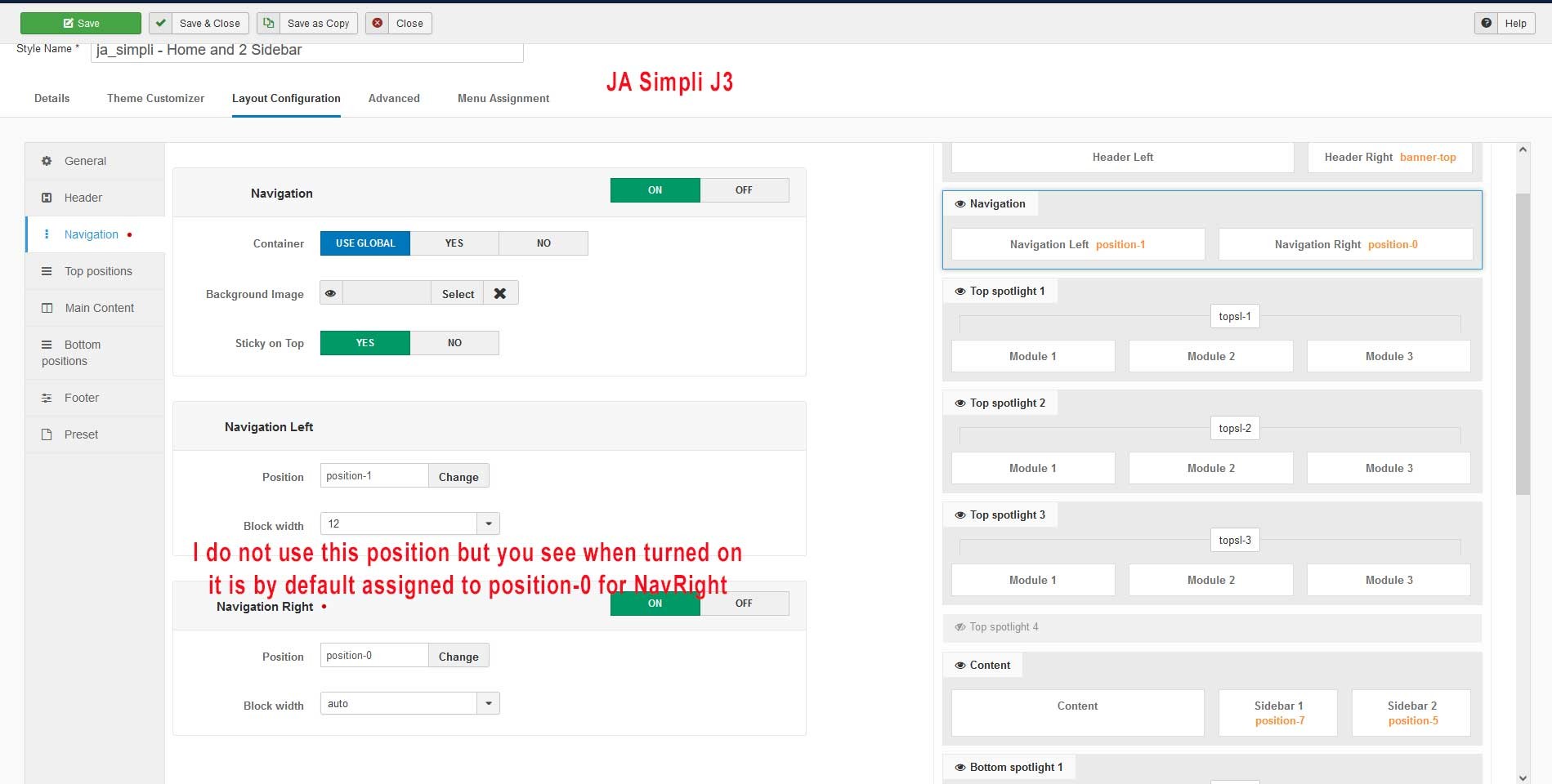

In the version of Simpli for J3 when you turned on positions, they had predefined positions. Such as Sidebar 1 was assigned to position-7 and Sidebar 2 was assigned to position-5.

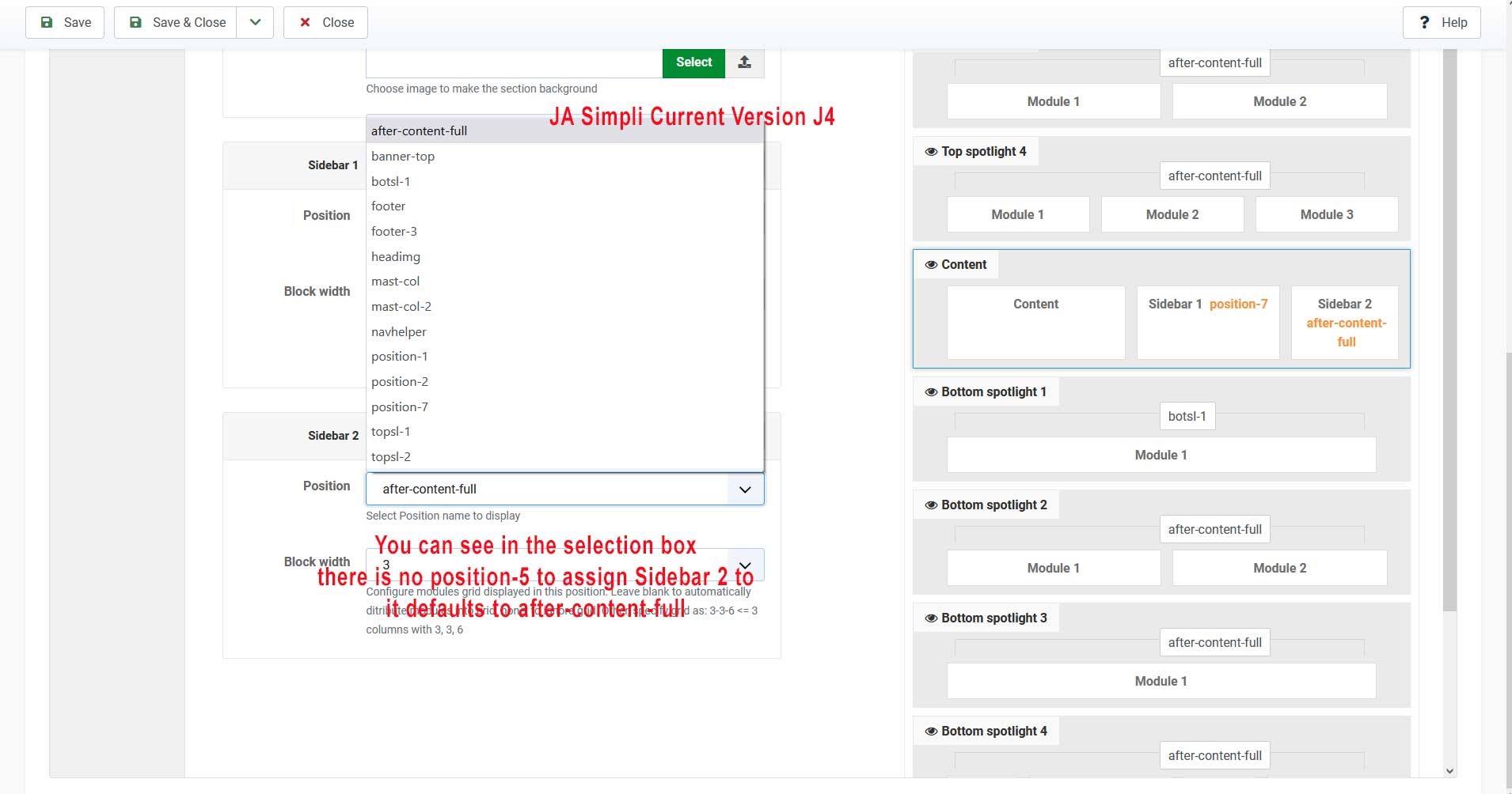

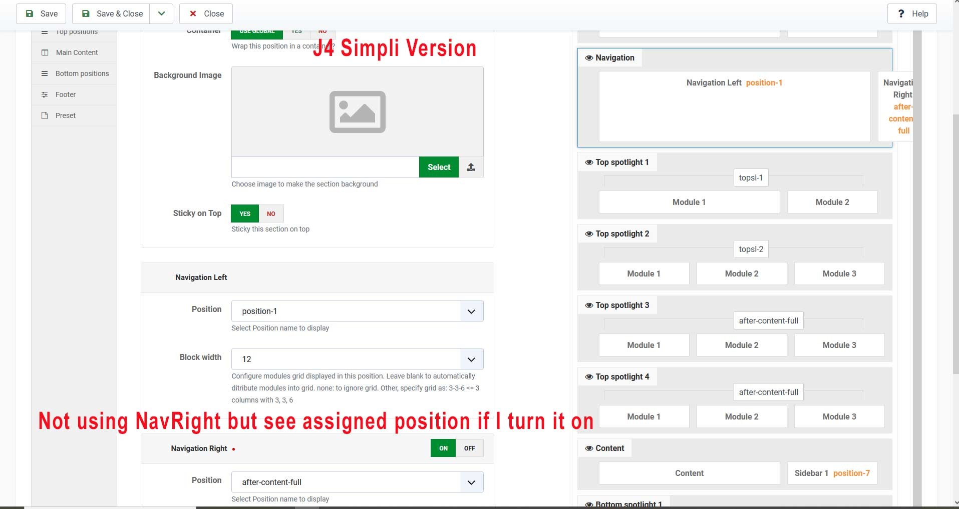

After upgrading to J4 and installing the update to Simpli, it appears that positions are not as they were before. Sidebar 1 is still assigned to position-7 but because I was not using Sidebar 2 (prior to updating everything to J4) the default position showing is after-content-full (which this is a position I created in the t3-bs3-blank template and a position I am still currently using on some pages).
So now in J4 using the updated Simpli template, all positions I had turned off - if I turn them on they are assigned to after-content-full. When I use the dropdown selection to Select a Position - it only shows the positions that are in use (in all templates styles I am using on the site).
For instance, if I wanted to turn on Sidebar 2 and assign it to position-5 - position-5 is not in the dropdown selection.
I'm pretty sure this is confusing and I have attached a few images to hopefully help with what I trying to explain.
