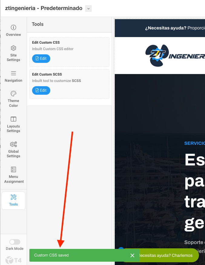

When trying to save changes in the template css using the T4 Framework tools, the following message is shown to me in the browser console
POST https://mysite.com/administrator/index.php?option=com_ajax&plugin=t4&format=json&t4do=savecss&id=22 Condition 500 Internal Server Error VersionHTTP / 2 Transferred10.54 KB (size 9.74 KB ) Referral policy strict-origin-when-cross-origin[upl-image-preview

I checked further on this and it seems that you're using CloudFlare on your site which may impact the Ajax functions - which is used for saving in template.
Could you please make a test by disabling CloudFlare temporarily and try to save in template again?
