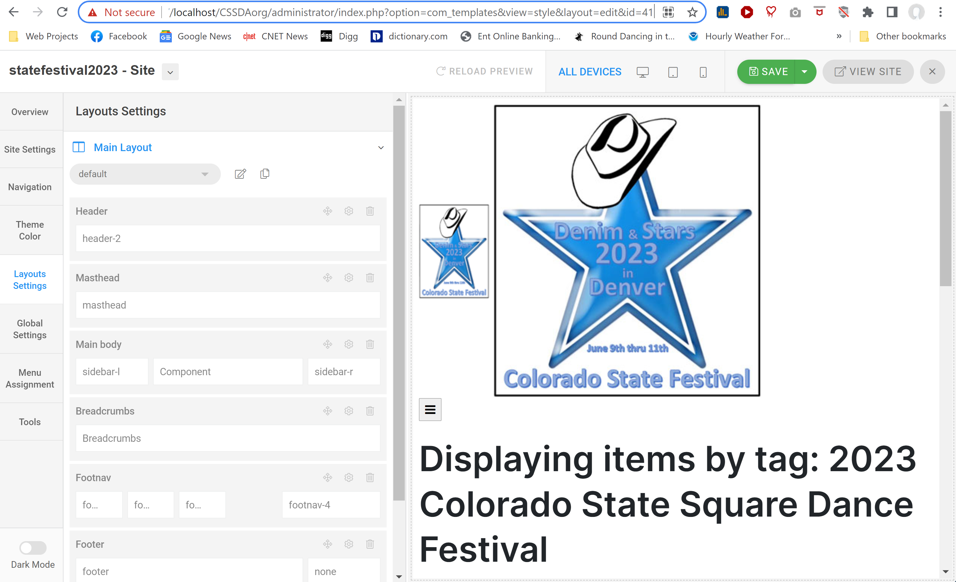

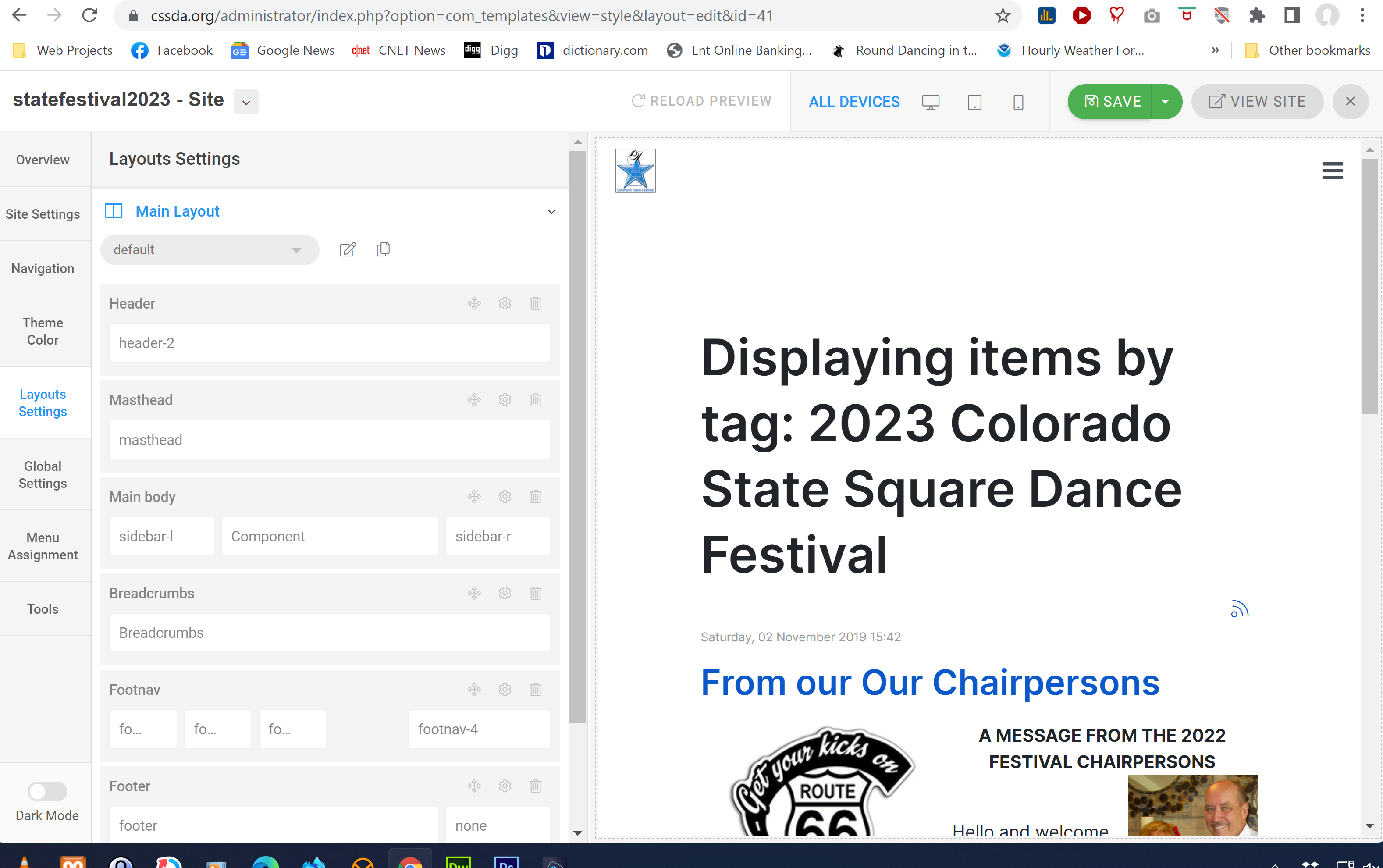

Hi, I'm developing a new site and would like to use the T4 Framework, but I've ran into an issue with the T4-BS5-Default Template producing differing results on my on-line (PHP 7.4.26) system vs my localhost (PHP 8.0.12) system. Both systems are running Joomla! 3.10.3 with the T4-BS5-Default Template. To get started I backup up the on-line system and did a restore to the localhost system. The attached screenshots illustrate the problem. With the same setup on both, except for the PHP version, each is displaying a very different page. Currently I don't have the option to update PHP on the on-line system, and since PHP 8 will be coming, I don't like the idea of developing for a soon to be depreciated version. Will there be an update to T4 in the near future for PHP 8? If not, should I just plan to use T3 and give up on T4?
