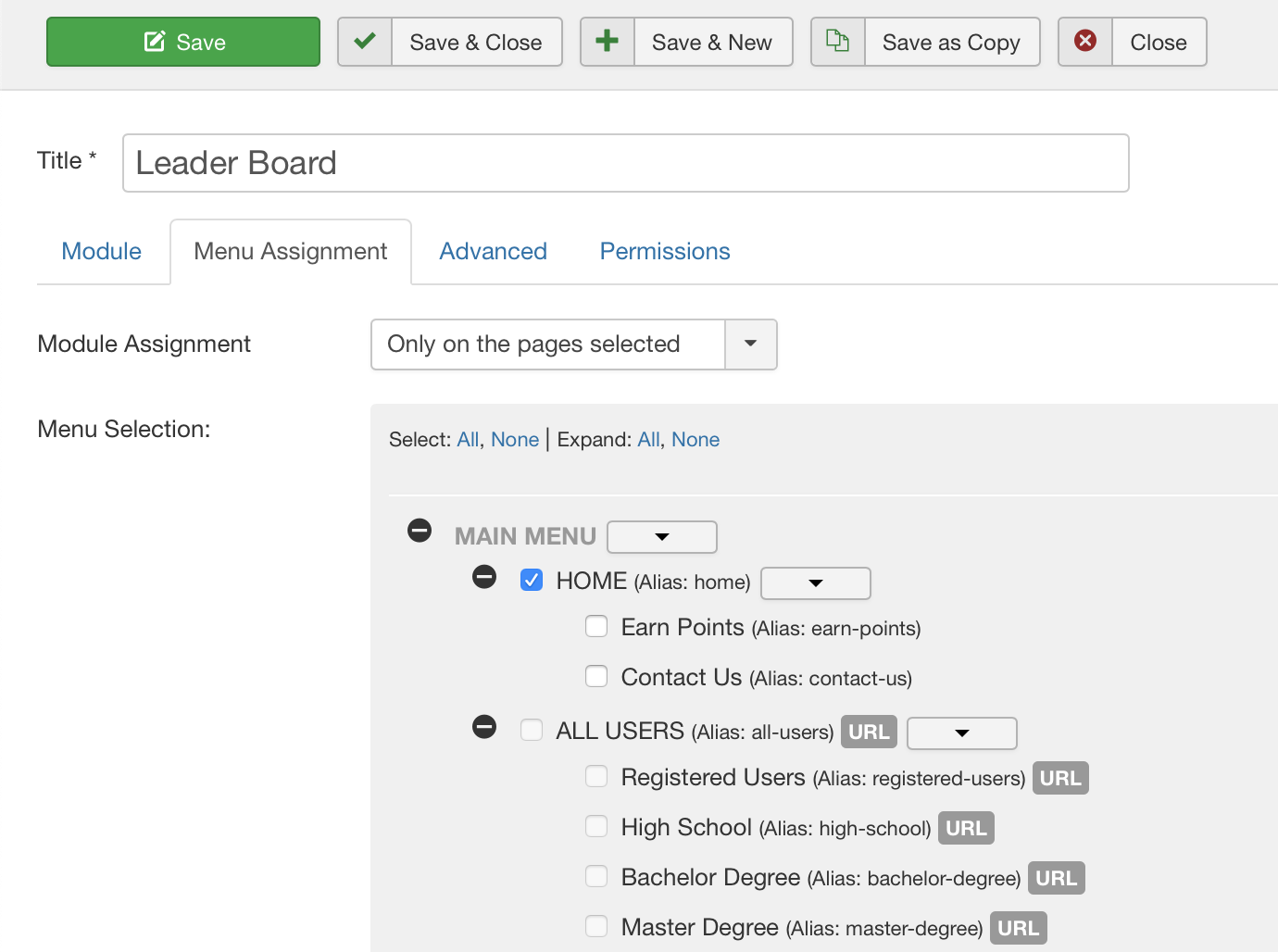

The problem is that you didn't have menu items for these pages so when you click to open, it's still under 'Home' menu item so that 'Leader Board' module is still displaying there (and it's correct).
What you need to do is that you should create menu item first, then if you want to use URL menu item type, you must point to that menu item created.
Let me make an example: Gender >> Men menu item: you add link with the search criteria from Easysocial component, it should belong to the search layout of Easysocial but you did not have any menu item for this search layout. I just created a new menu item called 'Search' in your main menu now (you can move to other menu or hide it). As you can see it will take the correct layout (cloned layout), and of course the 'Leader Board' module will not display there.
You can do the same for other menu item, that you should create menu item for type of page you want so that it can redirect to correct page.
