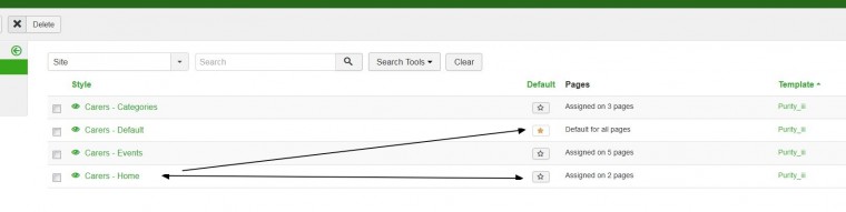

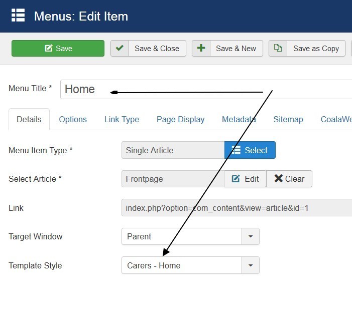

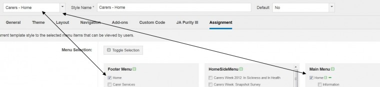

The issue is that when installing joomla 3.9.2 over Joomla 3.8.12, the home menu (assigned to its own template) reverts to rendering the the home page through the default layout even though it is still assigned to a different template.
There is definitely something wrong with Joomla 3.9.2 or Purity. And possibly only with local files.
